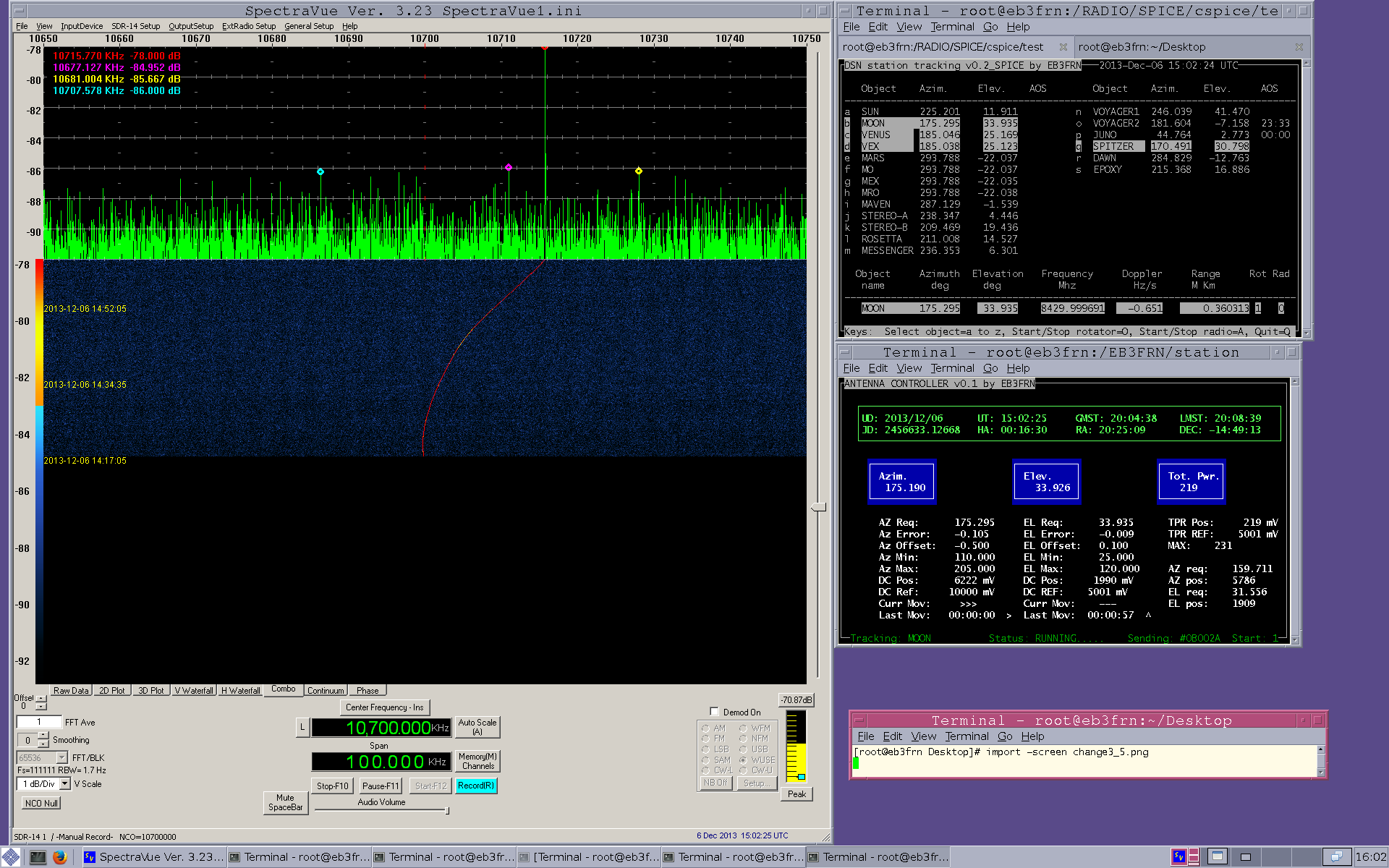

Прием подтвержден на:
8479.759 MHz
https://www.dropbox.com/s/i4m2hfz4x2pk1as/chang%27e%20Xband%2000.jpg
8479.768 8475.918 8483.618 MHz
8479.7726 MHz 25dB/1Hz and 8483.6277 5dB/1Hz
doppler inversion at 13.26UTC
8469.96100 Mhz.
https://www.dropbox.com/sh/or0g2of1bpxd0o3/f6rPTeVxRF
http://www.eb3frn.net/TMP/change3_5.png

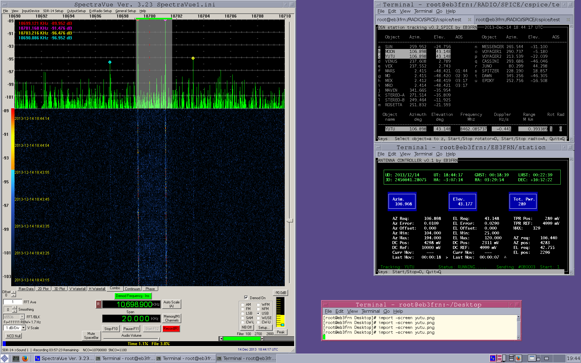

rover at 8462.085702 sending data. SN peaks of 15dB/1Hz
http://www.eb3frn.net/TMP/yutu.png
