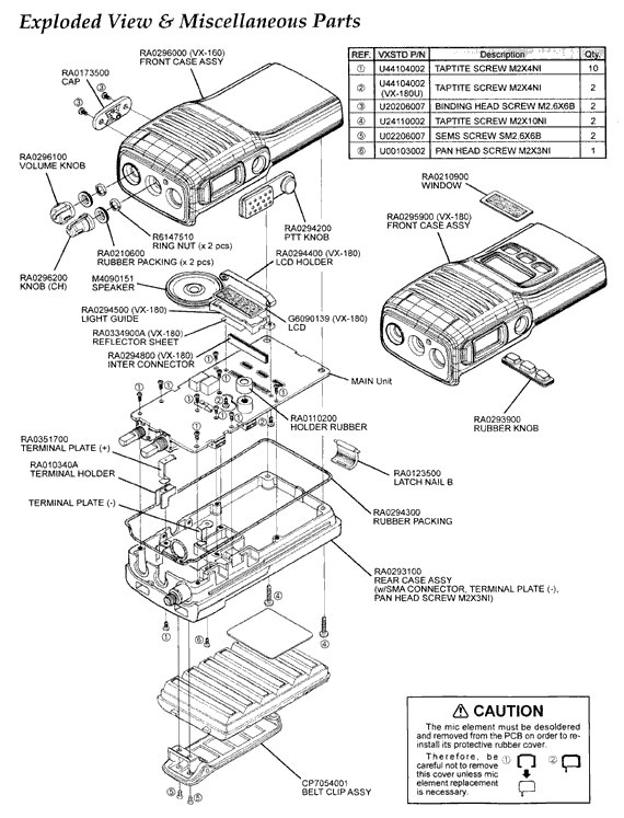

5. Vertex VX-160V / VX-180V - exploded view
